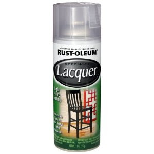

Haha, I do believe that is indeed glare, but I haven't graduated to envirotex yet. I use this stuff with pretty good results:

wow, I'm 0 for two! Good to know what works for others. I have this can of clear that I got from a craft store. It is really shiny but scratches if you look at it too long and fingerprints don't wipe off without leaving a smudge.
