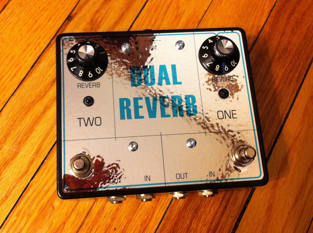

I finally got around to building this. It's a dual Hermida / GGG Reverb in a 1790ns with AMZ switching. I tried to get it to look like my '68 Showman since I'll be using it to provide reverb on both channels of that amp. It is designed to sit on top of it (hence the jack locations). It took a long time to assemble wire up. Like 7 hours or so. I think I may be doing it wrong. :) It worked first shot, though, and sounds great.
-Aaron

fantastic, great results!
Pcbs no longer available
Heck of of build!  Wonderful.
Josh
sgmezei
Wow that turned out great! I have been following your reverb builds and this turned out superb!
Mich P
Hey silverface !
Great build,
Congrats.
Mich P.
Class act!  Great work , thats fantastic
That's a great looking build.  I particularly like the graphics paired with those knobs.
pryde
Wow. Most excellent and tidy inside and out. Congrats!
Gadzooks! That's inspiring. It's been really cool to follow how you designed the boards and got to this bad boy. You even went all out with relay switching. Congrats, bud. This is a masterpiece!
That's pretty awesome.  :)

Thanks! Unfortunately, I can't really take too much credit for the graphics since I basically just copied the aesthetics of the Fender faceplate.
I tried it on a job this morning and it worked well, but since we played in a Gymnasium it was a bit difficult to really hear it. After messing around with it later this afternoon, I discovered that jumpering the two reverbs together in series and running them both at once sounds really really lush. It's funny because one side sounds slightly different than the other (I'm guessing that would be the tolerance of the carbon films coming into play) when played separately but together they kind of meld into one and add density to the effect. The only down side is that it gets a bit noisy when running both. I'm wondering if using metal film resistors would help that. Now I'm contemplating a version that uses two with a dual ganged mix pot and a "density" switch that toggles between one and two.
-Aaron

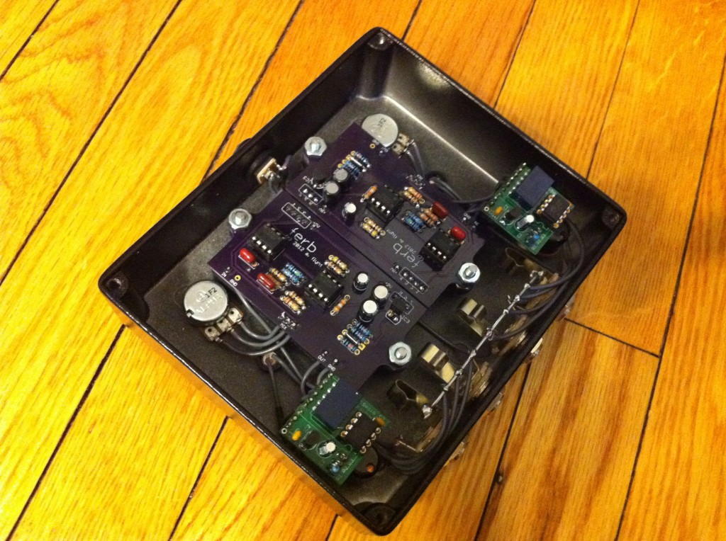

A few better pictures:

That is seriously awesome.
Really nice PCB design as well.
mjcyates
That's some great work inside there! Great job!
When running these in series the noise is most likely from the "bricks"  Just like running two pt2399's in series.  They add noise that needs more filtering.
