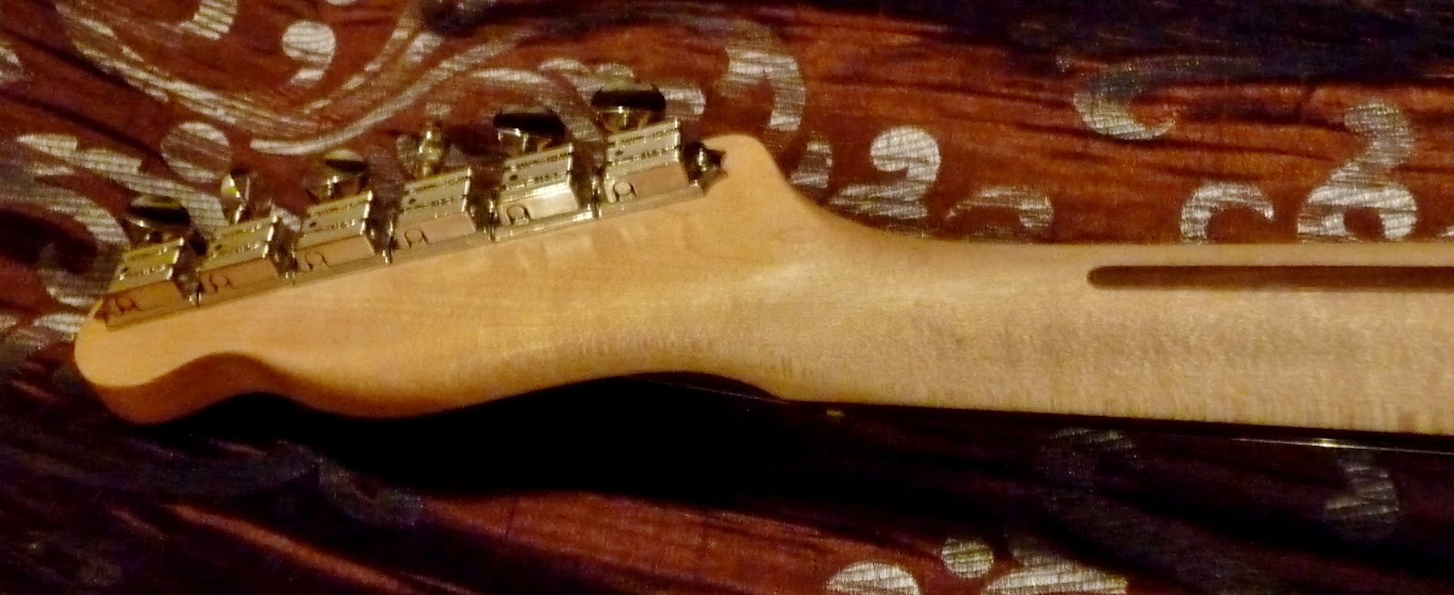

On p.3 of this thread I updated the specs of my guitar, but it has grown much since then:
Now has MIJ Jazzmaster pickups drilled through the bobbins to mount ike p-90's with a tele bridge pup plate screwed to the inside of the cavity and grounded for more twang.  A control plate featuring the distressed black sparke finish I have been using on my pedals, just a 3 way and volume with a .033 and 470k in series to ground for a fixed tone control.  Bridge is USA fender chopped at home with CJ Tooling 5/16" Cold Rolled Steel saddles.  Little bit of 60's mex alum. to cover the cleavage.  I recontoured the nec to make it soft v to c and rounded the backside of the "hump" on the bottom edge of the headstock while I was at it.  It has Tonepros Klusons with the bolt bushing now too.  Really love this guitar.
