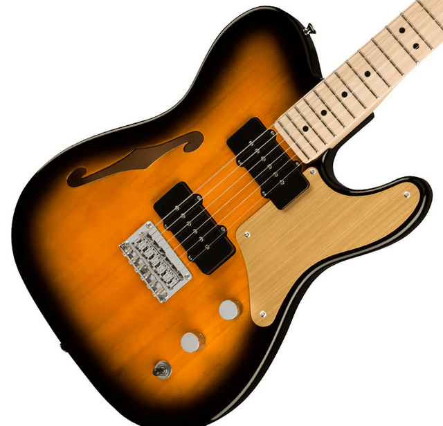

To get a better idea of what you're dealing with, is this pretty much the guitar you have? (I realize there are several color options).
If it is, then the pickguard really has no bearing on grounding or shielding, so that's irrelevant, and the control cavity doesn't have the typical telecaster metal panel that the pots and switch are mounted to. I'm guessing the wiring/grounding is more like a Les Paul than a typical Tele. That changes things, and is a key piece to know before moving forward.

Quote from: lars on June 28, 2023, 11:30:36 PM
thats the exact model down to the colour, yes.
