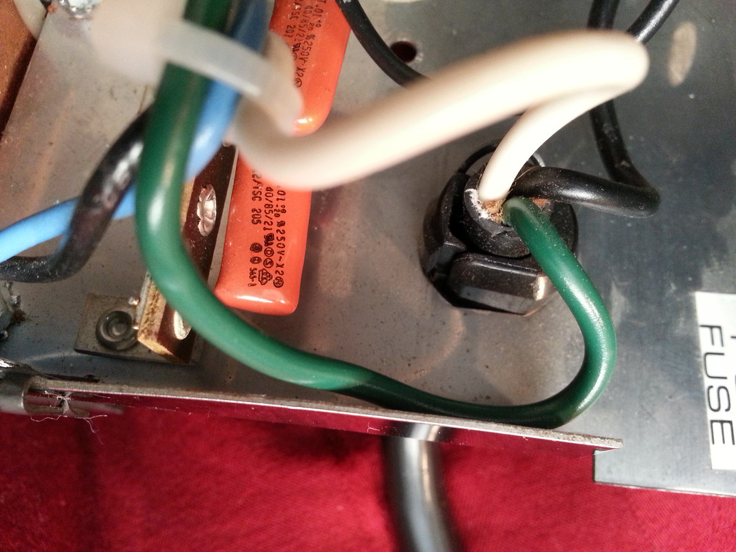

I've been tinkering around with a Peavey Classic 20 that I got for cheap, trying out different mods and such. One thing I noticed is that on the available schematics it doesn't show anything having to do with the 120v side of the power transformer (it doesn't show the power switch, main fuse, pilot lite). I guess that's because they didn't want people to know the completely idiotic thing they did. If you have a Peavey Classic-series amp, I would immediately check this to make sure you don't possibly kill yourself. Look at this:
What you're looking at there is a true "death cap". Peavey chose the wrong type of safety capacitor for the 120v hot lead to ground. An "X2" rated capacitor, like the one pictured, is an "across the line" capacitor. It is designed to fail closed in a short situation. So it doesn't take a genius to figure out what happens if it fails installed in that position. It will send 120v AC directly into the chassis, and if you're not hooked up to a properly-grounded wall receptacle, that also means into YOU since the input jack is grounded to the chassis! They should have used a "Y2" rated capacitor, which is designed to fail open and is specifically for line to ground situations. I would recommend immediately removing this capacitor if you have a Classic 20 or 30 or 50 (I'm guessing they all have this bonus bonehead feature).

Yes, most all if not all Peavey amps have these caps across the line voltage. First thing I do when one of these amps comes in is remove those two caps you took a pic of. Because these amps have a grounded plug (3 prong) those two cPs don't serve a purpose. TAKE THEM OUT! Lol!

And just to reiterate, the main problem is that Peavey chose the wrong type of capacitor for it's line to ground application. You can use line to ground caps all day, as long as they are "Y"-rated capacitors. Look inside any Furman Power Conditioner, and you will find them there. So most of us use "death caps" all the time, without even realizing it. But an "X"-rated capacitor is wrong, wrong, wrong, to use to ground. It will fail short, and send voltage into the chassis.
