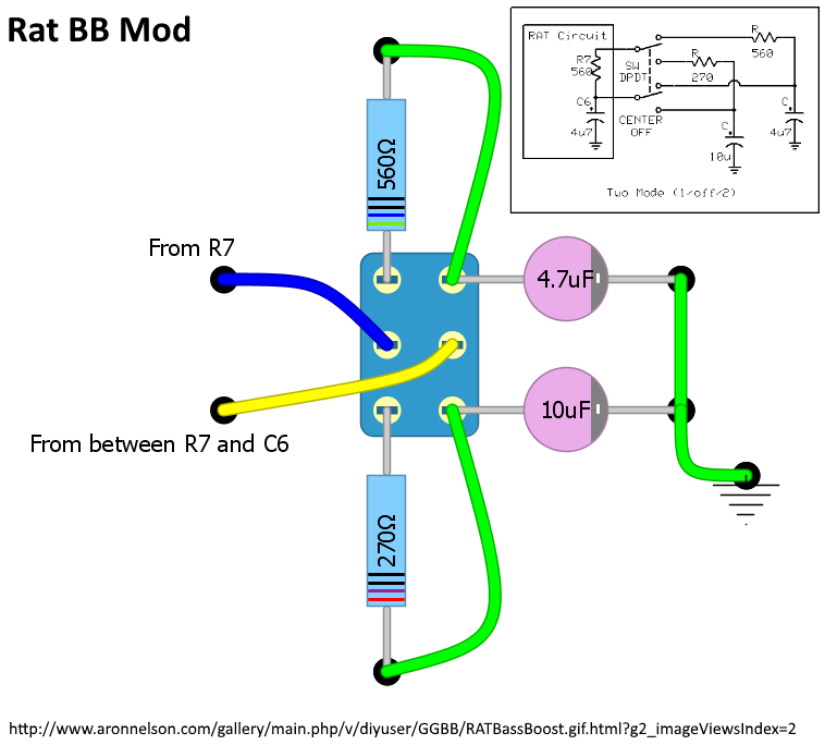

This has worked really well for me in the last 2 or 3 rats I modded.
