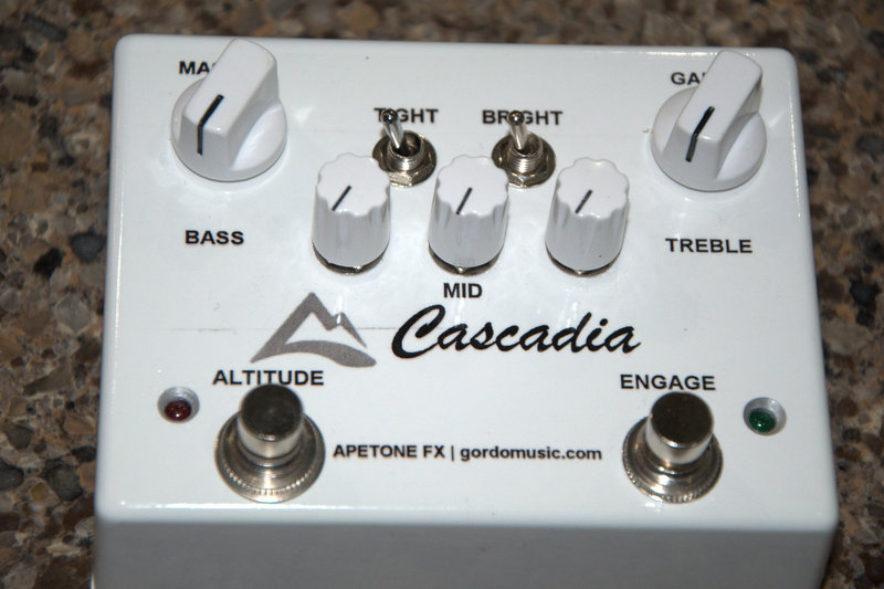

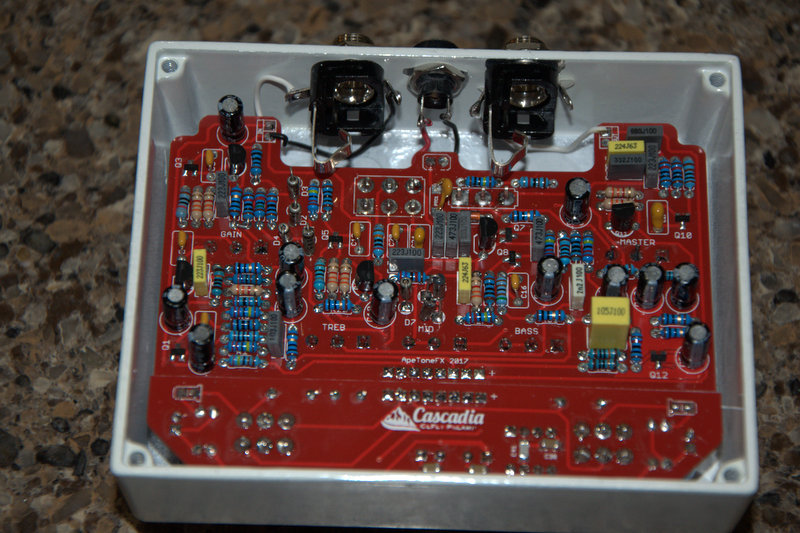

This one is a no brainer.  I chose to stuff it in a 1590BB and overshot on the jack placement.  It works.  Possibly one of my worst finishing jobs to boot but the photos are kind here.  This is a great pedal so it's not leaving the flock.
A really easy build despite the parts count.  Couple of wires to the jacks and power and you're done.  Bone stock with SB diodes.  Pretty true to everyone else's review: crazy range on the tone controls.  Great sounds over the entire range of the Gain control and really nice response to guitar volume.  My laser printer, an old Brother I've had since early 2000's packed it in on the decal for this one.

Were you able to fit the lid on without filing the lip on it down?

:-) Nope.  Had to file down the lip.  Worked though!

Thanks folks.  I don't know that for the reduced height it's worth diddling around with a BB enclosure but it's all I had.  Had a few moments of silence for the old printer and now it's onto a very cool Brother color laser so I might start moving away from monochrome graphics.  Woohoo!

So the pedal made it's debut this morning.  My drives were the Cascadia being fed with a GPCB 4-track fuzz.  Silly good combination.  In fiddling with the knobs I noticed that the Tight switch is now only working on the right hand setting.  Switching to the left drops the output to just barely audible.  Bummer.  So this afternoon I'll crack it open and see what's gone wrong.  Thinking maybe a pin of something shorting to the back of a pot now that it's been knocked around a bit.
If I'm reading the scheme right the switch is the difference between C30/R46/R47 and C29/C31/C32/R45/R48 right?  Unless the switch lost it's mind.
