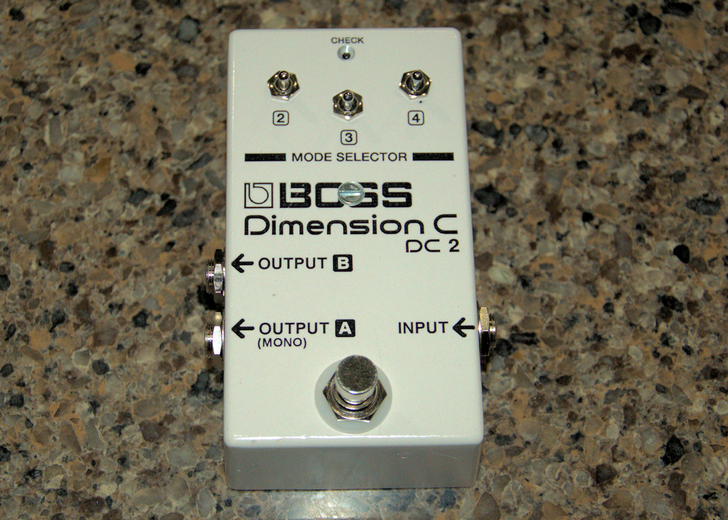

Nothing new here but it worked without issues.  A very tricky build and I really don't advise deviating from the docs.  I shudder at the thought of most "A" builds so keep that in mind.  This is a completely stock build so really doesn't need photos.  I leaned in on the original (including using the B**s name) but only out of respect.  If there's a downside to this build it's that all of Kevin's magic is hidden.  This layout is just crazy cool and the board(s) are very pretty.  Unfortunately you can't see them.
This was intimidating and while I jumped right in on the Aion Lab board I let this one sit on the shelf for a bit.  Nothing at all difficult as long as you respect the fact that you need to follow the build order and a few parts that deviate from typical builds (the 1uF WIMA caps are a good example).  Get your ducks in a row and prepare to spend a good number of evenings splitting up build tasks.  Kevin has obviously put a lot of thought into how he put this together so read the docs.
That said, if you've built up a big project then this one follows suit.
I'm putting my house on the market so most of my stuff is in boxes for the next while but I'll dig out my scope and get this thing dialed in.  I have to be close as it sounds amazing as is but the trim pots have a wide sweep.  I probably need to reread the calibration part but the TP contacts don't seem to make sense with the meter readings.  My bad.
Really superb project and hard to describe the resulting sound.  Not too far off the beaten path for chorus freaks but a vague modulation that doesn't really seem to start or stop.  There's no RIP at the top and bottom of the sweep.
Really just too freakin cool.  I'll touch up the top mount screw with a bit of black and white paint to hide it.  It's part of the original and good enough for me.  I used the original bypass method and is totally silent.  On top of that the pedal itself is dead quiet.

Beautifully done build. I see a ton of work there!
sonnyboy27
That looks awesome. Did you counter-sink the LED? Because I'm really digging it.
czapa tranzystor 2
Willybomb
These dimension chorus builds are nuts.  Great work.
mjg
Looks very classy, inside and out.

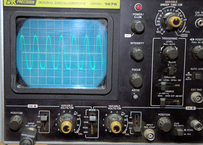

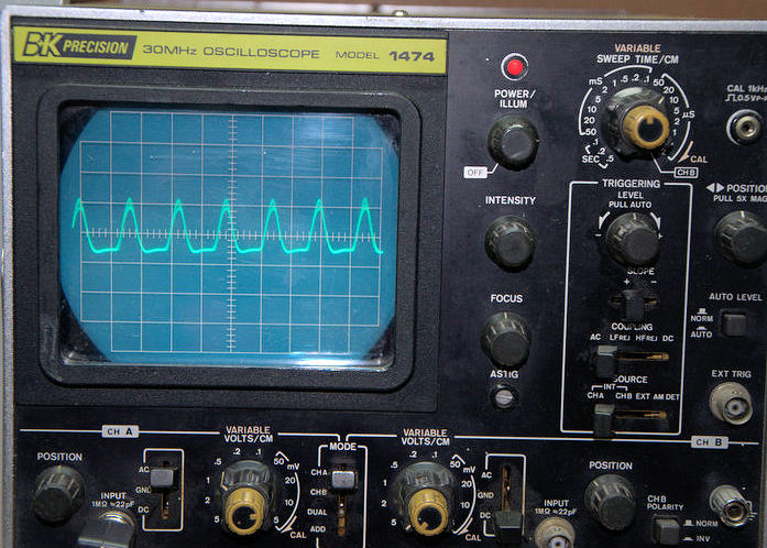

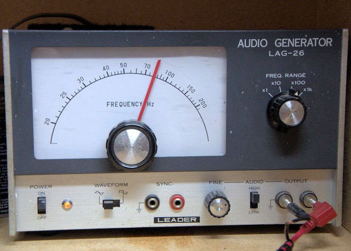

I got it dialed in.  I'm supposed to be getting the basement ready to show the house so these are secret photos of me goofing off.
This is my beat up old audio generator.  I love this thing.  Was an eBay score from some High School lab somewhere.  Super simple and one of these days I'll build a meter for the output level.
Here's one of the test points where I thought it sounded good.
Here it is after I tweaked it...
If you think you'll ever use it again, this project is a good excuse to pick up a cheap used scope or a cool pc based version.  This thing is a beater but has saved my butt a lot of times.  Think it set me back about $50.
