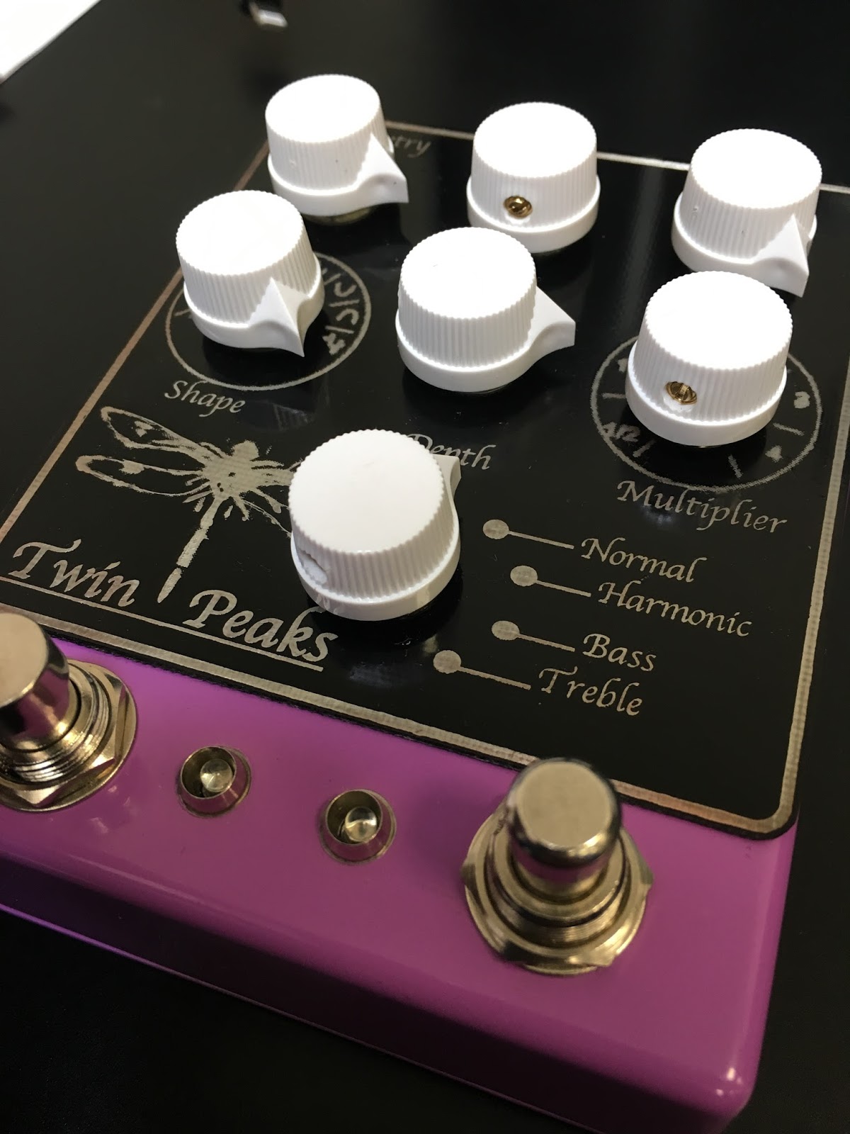

Got a message from someone wanting one of these and because I'm a PCB / Parts hoarder I had it all. Including a Purple enclosure that Jon (midwayfair) gave me forever ago. I did ste...borrow the face plate idea I saw here last week. But here is my build.
Hope you guys like it. I didn't have time to do a demo but this thing is awesome. I might need to order another from David at some point. Just a quick note I used the NSL7053 Optos and this is the older sandwich board from the first GB he did. Thanks for looking!

Nice work, Mike! Really dig the faceplate. What material did you use?
Guy behind Effects Layouts
Quote from: storyboardist on May 16, 2017, 02:36:41 PM
Thanks man. I used the 030 (thickness) / .5 oz (copper weight) of the black FR4 from ABCFAB. Then, simple toner transfer, etched, and then liquid tin. I sprayed it with an acrylic clear coat after to give it a little "shine"
Copper clad link
http://www.ebay.com/itm/10-pcs-FR-4-030-BLACK-4-x-6-2-oz-Single-sided-Copper-Laminate-Board-PCB-/311655091971?hash=item4890174f03:m:mNxrxiSFMSZ0W9vvqFfp5ZQ
This is 2oz so it would take forever to etch but it's that same thickness and seller.
