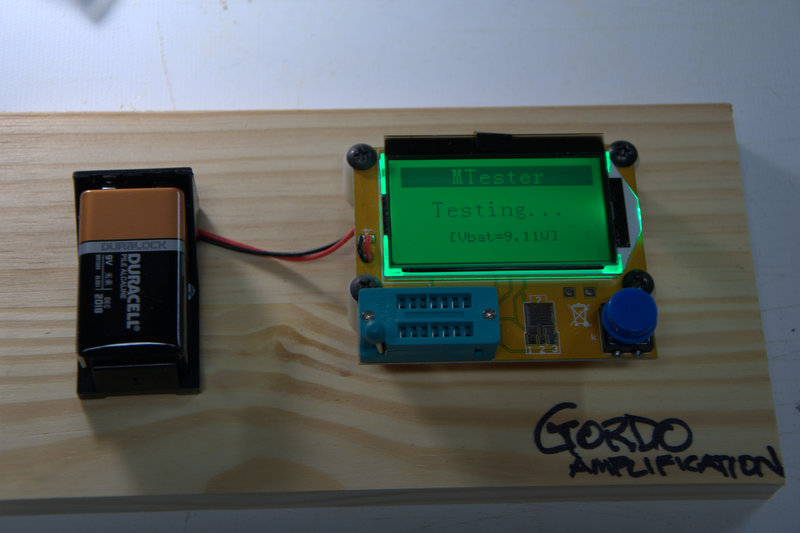

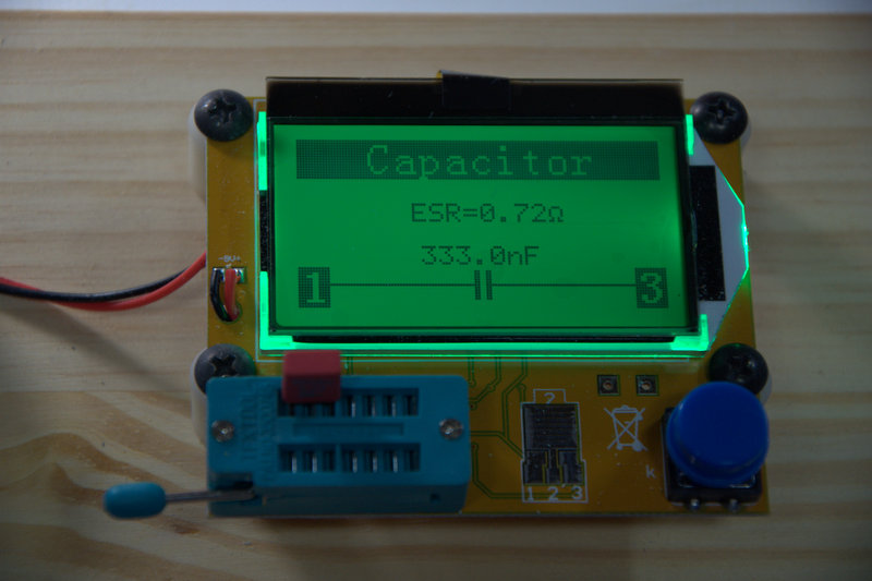

That paper clip resistor cradle is brilliant!  Wished I'd thought of it.  I hate troubleshooting so I measure all my resistors as I populate the board.  It has reduced my box of fail ratio to near zilch.

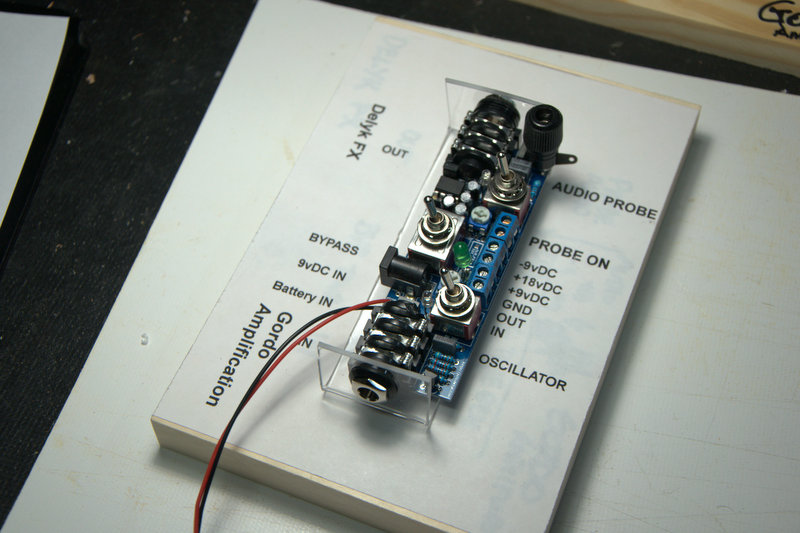

I picked up a gizmo similar to the Tayda one and can't believe how accurate it is.  At least with resistors.  I scored mine on eBay for $12 after reading a post from Pink Jimi Photon.  I have no idea how they can pull that off, I'd think the zif socket alone would cost that much.  I mounted it to a bit of wood to give it a bit more heft so I don't break it.
I ended up doing the same with my Delyk test rig.  Keeps it stable on the bench and I don't have to worry about plugging something into the wrong terminal.

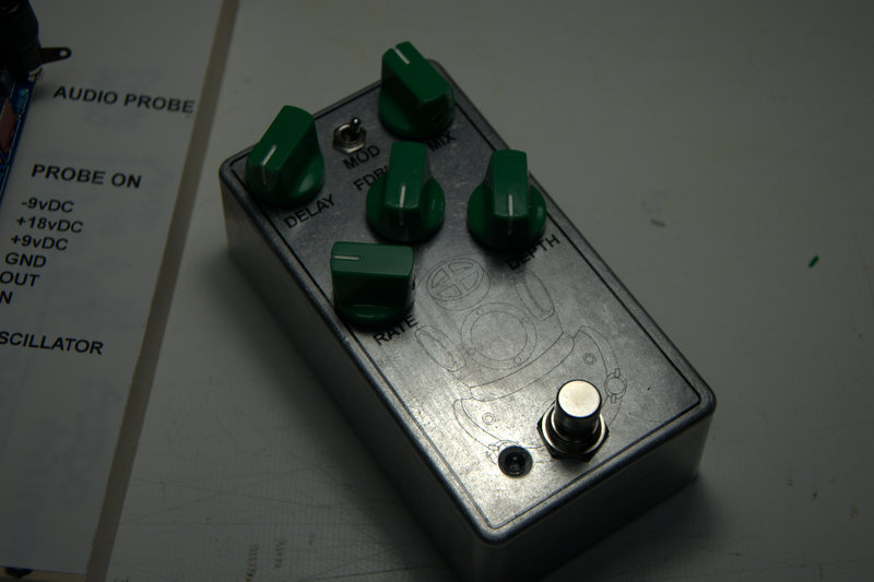

Guts go right from the rig to the box. Here's a gratuitous shot of the freshly minted AquaBoy with the Mod board.

any chance you have links to the resistor/ transistor tester and the test rig? thanks!

I do have the links.  The test rig is our own daleykd and this website is https://pcb.delyk.com.  I noticed the full kit (I got lazy and went that route - very recommended for instant gratification) is currently out of stock.
The gizmo: http://stores.ebay.com/frentaly?_trksid=p2047675.l2563
