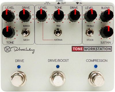

I'm dying over here, guys!  I'm trying to design a new pedal, and am PRETTY sure it can fit in a 1590BB.  It'll be almost all SMD, so that helps to a degree.
I was using the Keeley Tone Workstation as a basis for layout (it looks like it can fit 7 knobs on a top row!), and it has top-mounted jacks.
I also noticed pedals like EQD's Avalanche Run (while 1590BB vertical) fits the pots and jacks awfully close to each other.
Does anyone have any pics of the insides of something like this?  I'm trying to get an idea of PCB/internals layout and am struggling with this.  I was going to use the switched, isolated jacks like EQD so I could easily board mount them.
Thanks in advance.
(I may resign to a 1590BB Tall, but I'd rather fight to see if this is doable first.)
