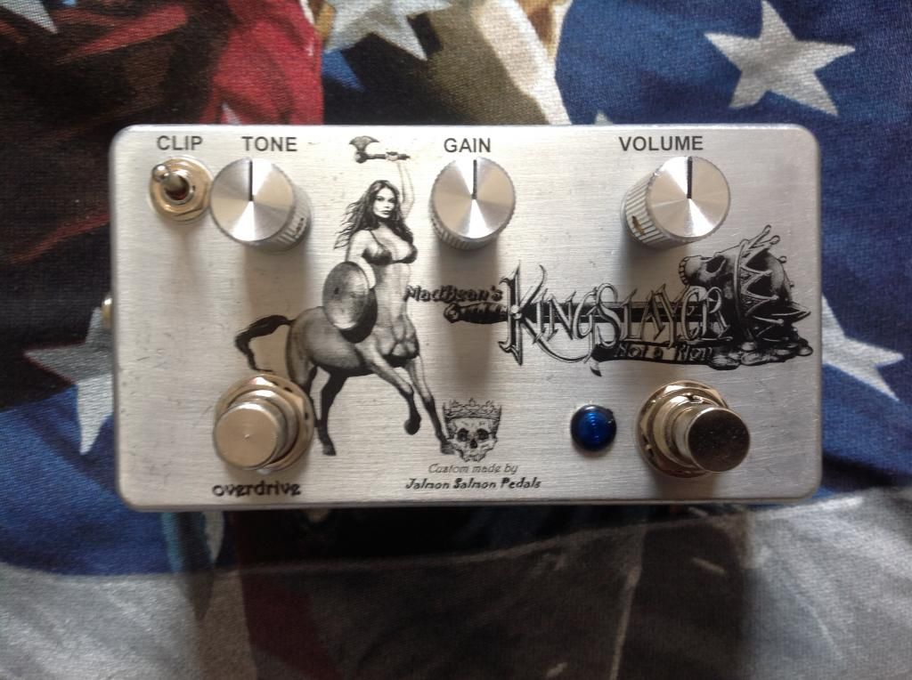

This one's been sitting on the bench quite a while, and I finally got around to boxing it up a couple months ago. Just now getting around to photographing it and writing a report. This was built on one of the 1.4 Low Profile Doppelganger boards from alanp.

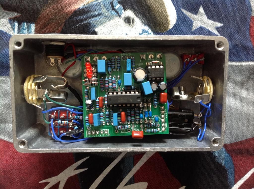

I boxed it into a 1590BB Tall so that I could use top mounted jacks, and used shielded wiring throughout after reading about ticking problems with others. Despite my best efforts, I ended up with ticking in this build. I tried swapping opamps, messing with lead dress, etc. and it was persistent on all but the highest speed settings while in Dual LFO mode. Single LFO mode is fine and actually sounds fantastic. Despite the ticking issue, this thing has kicked my Stage Fright off the board for the time being. It's such a great sound - deep, wobbly, vibey... so good. I did use a 2kb pot on one of the Span controls - the low, I think - for deeper response.

That thing looks great! This is an interesting build to consider; I'm looking for another phaser option. As far as the ticking, I did notice your input jack is directly above and close to your LFO op-amp (IC1). In another build that had no ticking, they happened to mount the jacks in a completely different location, far away from the LFO (everything else was the same as yours). Maybe try removing the jack from that spot and temporarily support it away from the pcb. Probably just a dumb idea, but worth a try.

That is a very cool build. I've also had the idea of using iron man on the cover and let his "battery" light up when engaged. So, are the LEDs in his hands the LFO indicators? everything in light blue?
Yes! You should definitely consider it. It's fantastic. I did mess with the proximity a bit regarding the jack and it didn't really improve anything. Wonder if I could insert some sort of shield in between...
Too bad you got some ticking in there, I hope you'll figure it out eventually.
Yep! LEDs synced to LFO, light blue of course :) Looks badass lit up. I'll try to post a video sooner or later.
