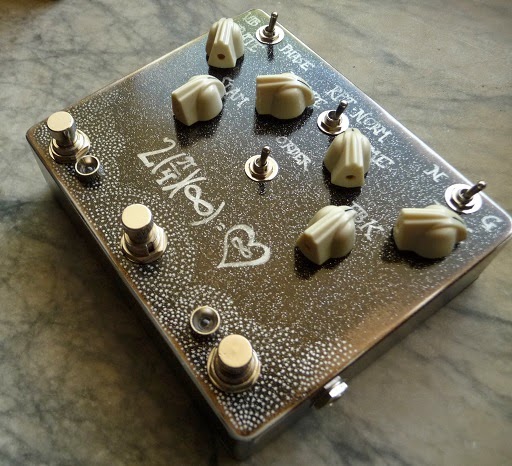

This one is for a guy from tdpri that missed out on the last one I built.  Again it is a Zero Point DD and Stomptown's fantastic Galacticon Phase Shifter.  I socketed the ghost resistors on the ZPDD, and have an OP275 op amp there, also it is wired for trails by moving R7 to a 3PDT.  The Galacticon has a 50kB pot instead of 20kB or 25kB and I think it gives a little more depth to the effect than the last one I built.  It also has the "uni-vibe" mod, however it has a 330n cap instead of a 470n cap for the uni-vibe pair.  The middle toggles are the same as the first, allowing switching between the Phase 45 on the repeats or on it's own and order switchable to be before or after the delay.

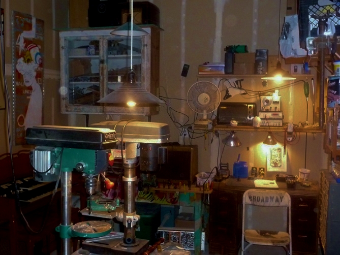

Congratulations Tim, you definitely deserve the recognition. If I can prove the Jefe I got from you was built on a card table I think I have a small fortune on my hands. lol
Sorry Cody, the card table is my packaging/shipping table, it was built on the curbside rescue 1920's desk pictured below:
May increase the fortune factor?
