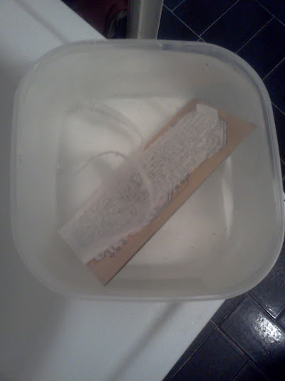

Oh, I etched this monster board myself, completely DIYed it, came out great, used the magazine paper/iron method. Wasn't easy, but turned out fantastic. A couple of pictures of that

Wow the looks great. Also, I commend you on the magazine transfer method. I fought and fought with that method when I first started etching and I gave up. I just could not get solid results but yours is great.
