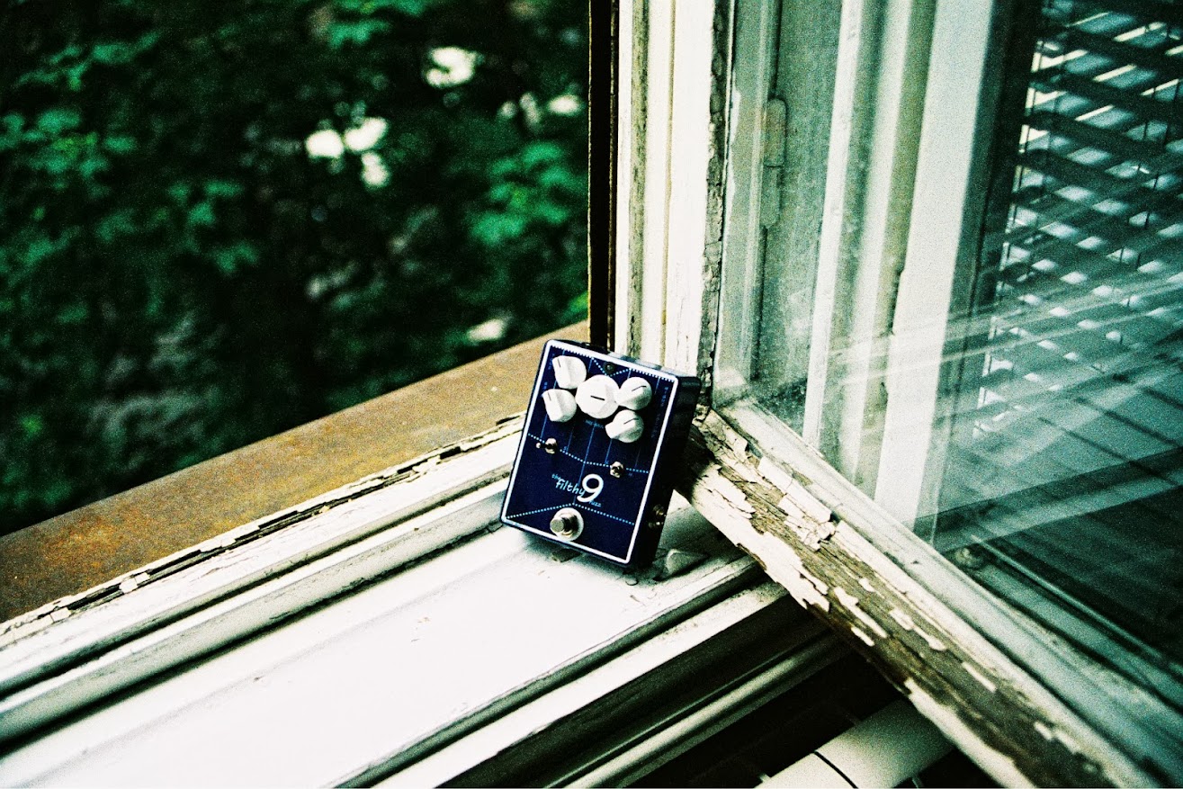

I wanted to post this as a contest entry, but since my photos are not very well lit, I decided not to. [still, if Brian and the gang sees this as no major obstacle, they should let me know!]
I used a cross-process AS film, it never lets me down, but this time the photos have incredibly bad contrast and are overall too dark. Still, I like them, I like the increased lo-fi-ness of these, hope you will too.
I built this for a friend, I gotta fetch it off him sometimes and make better photos cause I failed quite epicly with this macro shots, which doesn't happen to me that often... oh well.
It's a Pharaoh version of the Muff yeah [like 4th or 5th that I did], and I added an extra pot which makes a ton of difference, no other mods than moded to extra quality components :D

Post this for your contest entry. If you're able to take better photos before tomorrow night, replace the pictures in your thread.
If you turn down the contrast in those photos and bump up the midtones, you might be able to make the guts clearer.
I really think you should enter this.  I would like a few clearer photos.  Not just for the contest, but because this looks like a really cool build and I'd like to admire it up close.

High contrast photography is the new goop- you have to protect your secrets somehow!

Thanks guys, but I fear I can't get better images in time, still it is YAM [yet another muff right] so what the heck, as much as I would like to be a part of the competition it doesn't matter, I'll enter it next month. Haven't been building lately that much to tell the truth. Though I have a Ge od/fuzz coming that will rock your world. It has been the end of my perfect fuzz quest, I hope I will show the finished build to you in a month or two.

This time I used carbon comp resistors, Evox Rifa, Silver Mica, and Styroflex capacitors, as well as some Panasonic electros. The transistors I ended up using with this particular combo of parts were BC192's, I liked them best in this circuit [though I have used 2N5089, 5088, and BC550C with this build very successfully] but all of the others gave too much gain and I ended up having a horrible fizzy sound. Then I switched for the bc192 and the sound became much better. It came to me as a great surprise when I measured those and got something a little bit over 200 in the HFE range. That's some crazy low gain, compared to 2n5089s! Still, the pedal never lacks sustain or gain, quite the contrary! This may be the gainiest, bassiest, and smoothest one yet.

The placement of the battery on this particular build [first time I have ever done something like this] is weird, I know. But my friend wanted me to make this pedal exactly the way I made one of the previous ones, but have the footswitch in the middle lower part of the enclosure. So i did what I could to wire everything according to how I was experiencing the least noise and still respect his wishes. Not my best wiring, but hey, sounds great, it is reliable, and replacing the battery is not hard at all.

I'm gonna skip this one, it was my fault not shooting a couple more ones at least with my mobile phone just in case. Lots of great builds in there, voting will be really hard as every month is.
Dude, put it in already and stop analyzing the pics! If you hadn't said anything, I would never have noticed.

Do the pics really have to be good enough to clone the pedal with one glance? I can see switches, a circuit, a battery and some pots- if these pics aren't good enough to enter the monthly contest I might as well pull my entry, because I don't see a great deal of difference.
In short, just enter the thing! It's a beauty and deserves to be there.

The pics are fine.  More than adequate to see that you actually built it.

No, that's what I like about the photos.  They're so stark and harsh.  That's a very cool look.  Plus the pedal just rips.  Nice demo.  I've never built a version or variant of a Muff that has panned out.  The other guitar player in my old band in Canada and I get together every few years and I can play his rig with his mid 70's Muff and it sounds like crap and when he plays the same setup it's magic.  I keep hoping I'll "get it" one of these days.
