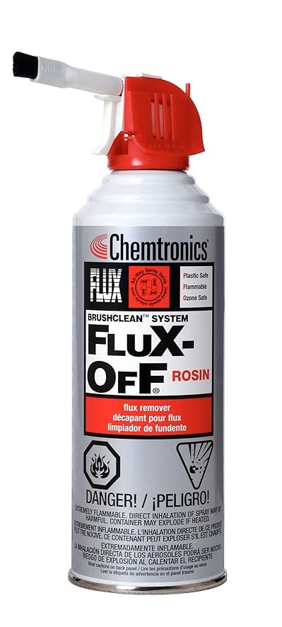

I often do a first pass with isopropanol, but that leaves the board sticky, so I will often do a final pass with flux remover (there are many variants out there).  The flux remover is nasty stuff, so make sure to use it in a ventilated area.  I usually spray a little on and scrub it with a dedicated toothbrush (never been used for actually brushing teeth).
Also, clean the board before you put on sockets, pots, trimpots, or basically any part the flux could wash into as it can ruin those parts.

I notice the isopropyl leaving sticky residue and that is why I asked.   What is the difference between Isopropyl and Isopropanol? I have old roson core from the 90s pretty messy stuff.  When I can I'll modernize my solder.

Isopropanol is Isopropul alcohol.  Just make sure you use the high purity stuff.
Flux remover works a lot better and requires fewer passes.  It's much easier to get the residue off.  That said, it's nastier to work with and more expensive.  A can should last a while if you use it sparingly.
You can even get it with an integrated brush if you like:
