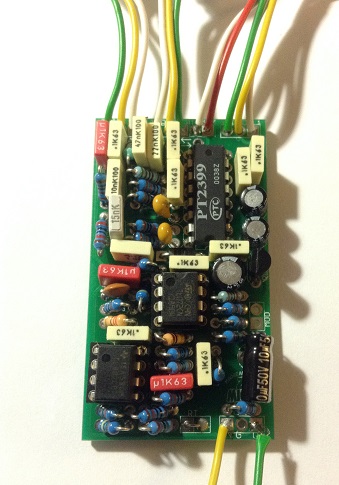

Hallo,
I tried everything getting this project to work. Many hours with no luck.
But I'm out of ideas and knowledge how to proceed. :-)

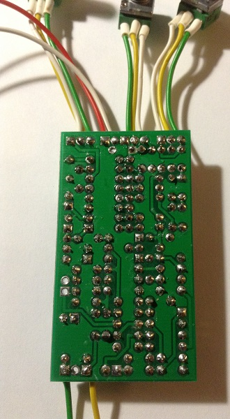

I checked the wiring, components, soldering and everything for several times. But I've found no mistakes.
I have not connected the mod toggle jet and have no clamp mod done.
Problem:
I have a clean and dry signal through the effect.
If I turn all the poti's to maximum i can hear one repeat.
But it is not very loud.  I measured the regulator and it outputs 4,9v.
IC Voltages:
IC1 (TL072)
1 - 4,8v
2 - 4,8v
3 - 4,8v
4 - 3,1mV
5 - 4,4v
6 - 4,8v
7 - 4,8v
8 - 9,6V
IC2 (PT2399)
1 - 4,9v
2 - 2,4v
3 - 3,4mv
4 - 3,5mV
5 - 2,7v
6 - 4,4v
7 - 11mV kind of moving
8 - 0,5V
9-16 - 2,5V
IC3 (TL062)
1 - 3-6v moving
2 - 4,7v
3 - 4-5v moving
4 - 60mV
5 - 4,7v
6 - 4,7v
7 - 4-5v moving
8 - 9,5V
