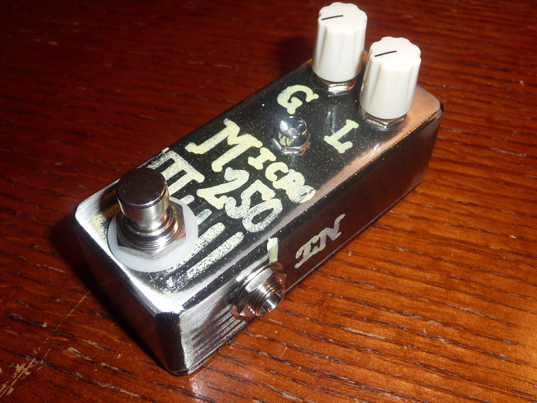

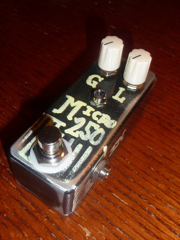

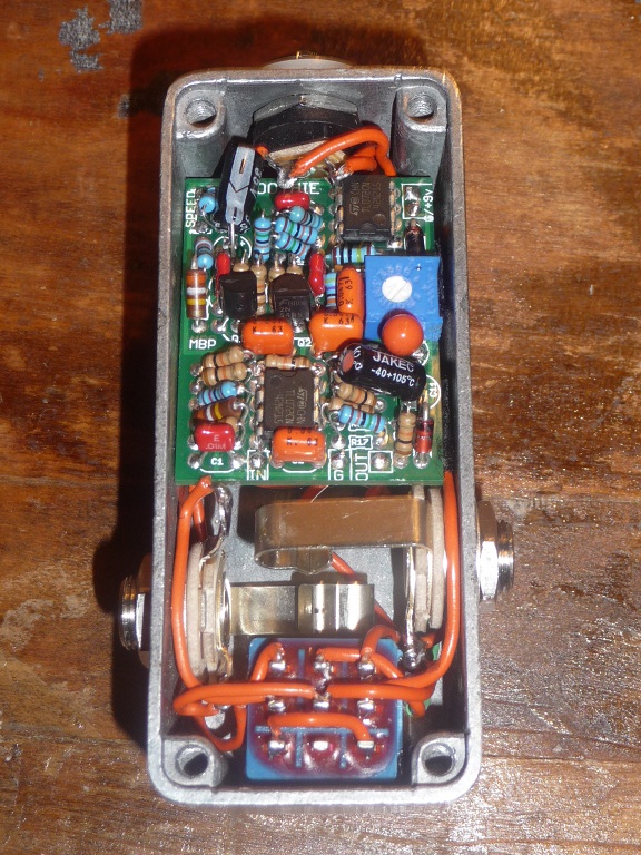

I like it with the Tungsram OA1160's that are in there, but stock 1n4148's are nice too for a crisper sound.  Just subbed the parts to make it a '77-'78 Grey spec DOD 250.  Next up is a Darkside in a 1590bb, I think I am gonna have a bit of the agoraphobia Jon mentioned a few days ago in his Trrr-treeeh build report!

Was'nt it a LF351N in the grey DOD250?
LF351N was in the later yellow versions, LM741 were in the grey ones.  I looked at a bunch of different layouts and schematics as well as gutshots of all the greys I could find for this one th nail down the vaules.  There are alot of discrepancies in the different info out there but I tried to match up with the gutshots using the other stuff as a guide to spotting what was what.  of course with the non-original diodes in there it isn't a true Grey 250!  Really liked working with this little board.
