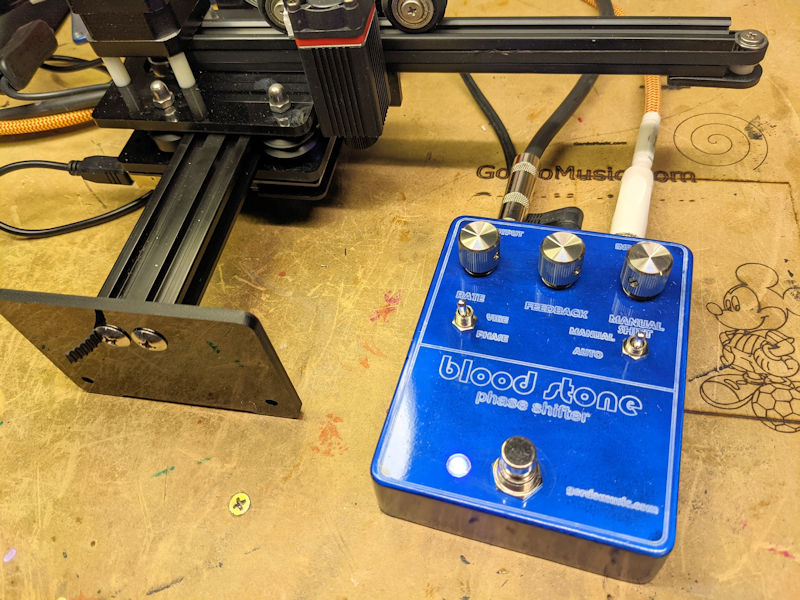

I'm getting better at getting things to line up.  wintersoldier inspired me to box up my Blood Stone and I must admit, I really like this phaser so glad I got it finished.
This is a shot at doing the outline of characters with the laser but I think it ends up looking too fuzzy.  Still, I'm making progress so no complaints.  I need to figure out how to output these files to G-code, which is what the engraver speaks.  There are tutorials out there for Inkscape and I'm hoping to use Affinity Designer as well but need to sit my butt down and figure out how it works.
Anyway, this was sprayed with translucent blue over a 1590BB enclosure and then etched and has a light backfill of white acrylic (that ended up hanging on to the blue parts for dear life and was a pain to get removed).  I'm thinking plain old craft paints would be a better choice.
