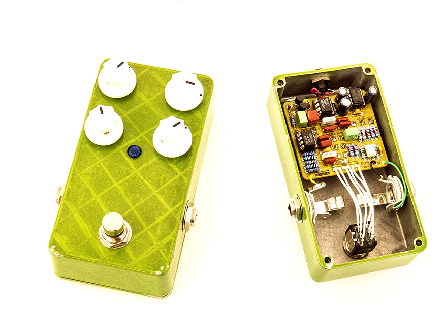

Quote from: wgc on September 19, 2017, 11:17:56 AM
Awesome! Gotta love those happy accidents. Probably the powder has some tiny pores as a result of a small application/ baking mishap that is hard to see without much contrast.
I changed around my 3pdt wiring a bit after doing a few high gainers. The typical way we do it puts the ins and outs right next to each other, inside the switch. Now my led is in the center column.
Try setting for oscillation and put your finger on the switch contacts to see if you can get some type of change.
I didn't notice pores under the microscope, but I also wasn't really looking for them.  Either way, it's funky.  It was a new type of acrylic paint, so there's that variable as well.  I'll keep experimenting.
Yeah, I'll play around with the oscillation when I make time to crack it open again.  Apparently, a lot of folks on FSB had issues with that as well, so there could be a wrong part value in there, too.

Quote from: Aleph Null on September 19, 2017, 09:31:28 PM
Great results. That accidental etch should maybe become an on-purpose etch.
Thanks.  I think reproducing this as an on-purpose etch would be a recipe for frustration.  We'll see, though.

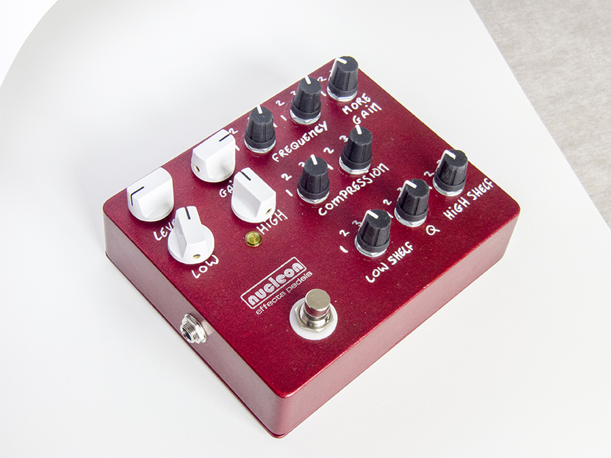

Quote from: jimilee on September 20, 2017, 12:23:07 AM
I can see space for a few more knobs.
I suppose I could put some on the bottom, but that might make it sit funny on the pedal board.  ;-)
This one wasn't the worst, actually.  Once I did a 2-in-1 1590A that had all this plus a 3PDT toggle and 2 extra LEDs.  I'm NEVER doing that again.
