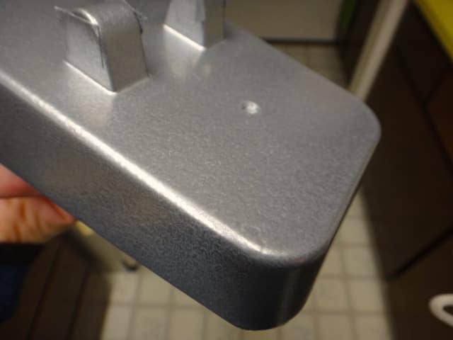

I read online that the old additive used for the hammered effect is silicone. So I tried spraying a regular spray paint, and then spraying a light coat of silicone lubricant over the top before it's dry...with very good results! The best part is that you can control the effect to a degree, depending on how much of the silicone you spray on. If it starts to get too extreme, you can just hit it with some more light layers of the paint, which actually looks even better. The paint has no problem drying even with the silicone spray mixed in. And the best part is:  no divots.
Here's an example of what I'm talking about:  the first picture I used Rust-Oleum Hammered brown spray paint. Notice all the divots in the surface and no value changes in the color? It looks like paint.
The second picture I used standard silver spray paint with silicone lubricant sprayed between the layers. Notice how it has an almost 3D effect with lots of value changes in the color, yet the surface is relatively smooth? It looks like metal. That's what we want.

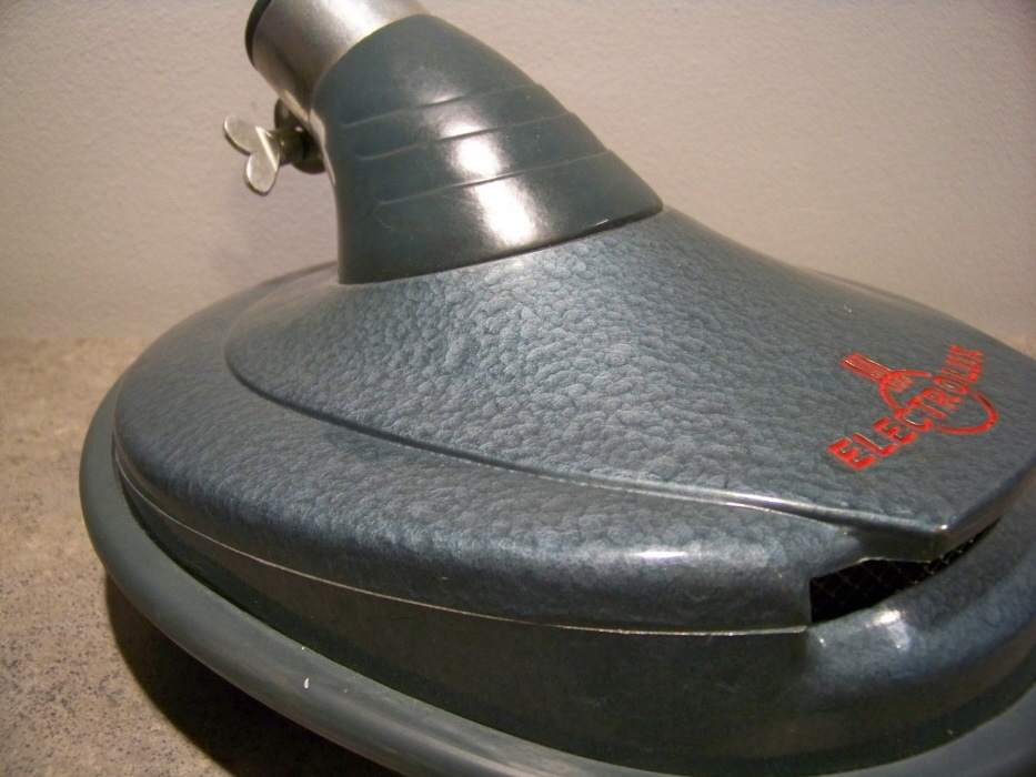

Yeah, me too. But this has more to do with us being stuck with poor products these days. True hammertone finish has a smooth surface, but lots of depth to the color, like this:
(unfortunately I don't think this type of paint exists on the planet anymore)
