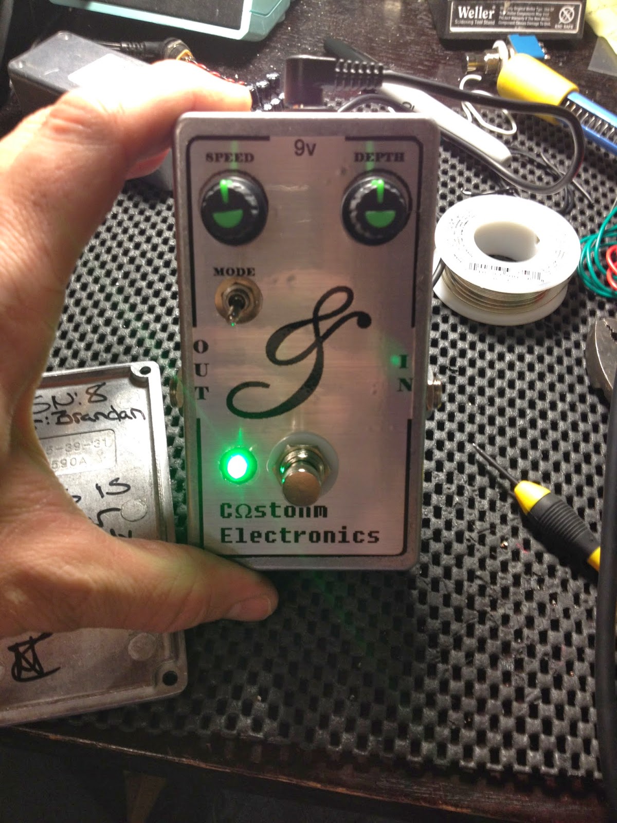

Thanks everyone for your kind words.
Quote from: jubal81 on April 05, 2014, 11:47:13 PM
Any tips for sanding after painting? I can't see that you've disrupted the paint in any way when sanding back the raised portions - so slick.  8)
I found that the matte and flat paints can cure faster and work best. The past, I have tried glossy paints and it seems like they will not cure fully and will turn black from the wet sand paper. I use a small wood block and 1000 to 1400 grit wet sand paper and just take my time. After I am done I shoot the whole enclosure with a matte clear. Hope this helps.

Flawless, simply flawless.
timbo_93631
Really pretty build Cody
