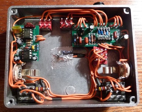

"Radio Sweetheart" is a La Vache with a Bacon Bits boost that is switchable to be on the input or output with an order toggle.  The gain boost toggle also lights the beacon at the top of the radio tower when engaged!  Advancing squadrons of bombers are my only addition to the otherwise perfect artwork by Fabien also on OSG.

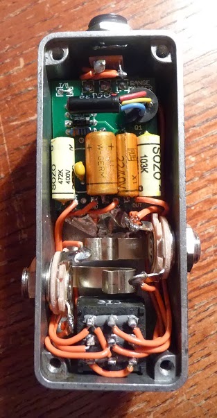

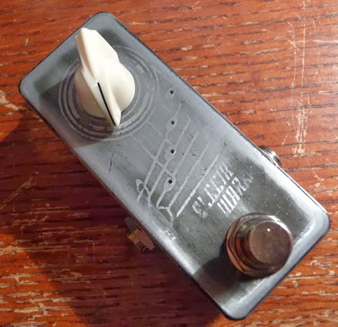

"Electric Warrior" is a NPN Rangemaster clone with mojo parts like ERO axial electrolytics, Sozo axial input and output capacitors, and a beautiful black glass OC139 germanium transistor, the T/M switch pads are jumpered and a MLCC cap is paralleled with the .0047 Sozo to get the value dead on.  Artwork also by Fabien, pinholes light up violet on the musical notes when the effect is engaged.

You have been busy Tim. They look so clean. I always look at your wiring and think how I can improve mine.  They are always inspiring.

I think my favorite thing about these builds is that you could probably fit the Rangemaster completely inside the other pedal. All that empty space in the middle is crying out for it!
